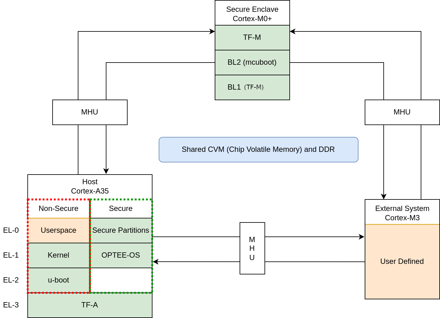

Design Overview
The software architecture of Corstone-1000 platform is a reference implementation of Platform Security Architecture which provides framework to build secure IoT devices.
The base system architecture of the platform is created from three different types of subsystems:
  • Secure Enclave
  • Host System
  • External System
Each subsystem provides different functionality to the overall system on a chip (SoC).
CorstoneSubsystems
Secure Enclave
The Secure Enclave boots first on system power on, it provides PSA Root of Trust (RoT) and cryptographic functions. It is based on a Cortex-M0+ processor, CC312 Cryptographic Accelerator and peripherals such as watchdog and secure flash.

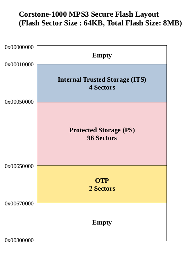

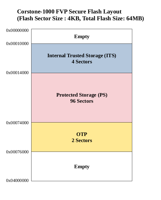

Corstone1000SecureFlashMPS3 Corstone1000SecureFlashFVP
Software running on the Secure Enclave is isolated via hardware for enhanced security. Communication with the Secure Enclave is achieved using Message Handling Units (MHUs) and shared memory.
Its software components comprises:
The software design on the Secure Enclave follows Arm Firmware Framework for M-Profile processor (FF-M) specification.
Host System
The Host System is based on ARM Cortex-A35 processor with standardized peripherals to allow booting a Linux-based operating system (OS). The Cortex-A35 has the TrustZone technology that allows Secure and Non-secure security states in the processor.
The boot process follows Trusted Boot Base Requirements Client. The Host System is taken out of reset by the Secure Enclave system during its final stages of the initialization.
In the Secure world, the Host System runs:
In the Non-secure World, the Host System runs:
The software design in the Host System follows Arm Firmware Framework for Arm A-profile (FF-A) specification. The communication between Non-secure and the Secure world is performed via FF-A messages.
External System
The External System is intended to implement use-case specific functionality.
The system is based on Cortex-M3 and runs Keil RTX5.
Communication between the external system and Host (Cortex-A35) can be performed using MHU as transport mechanism. The current software release supports switching the External System ON and OFF.

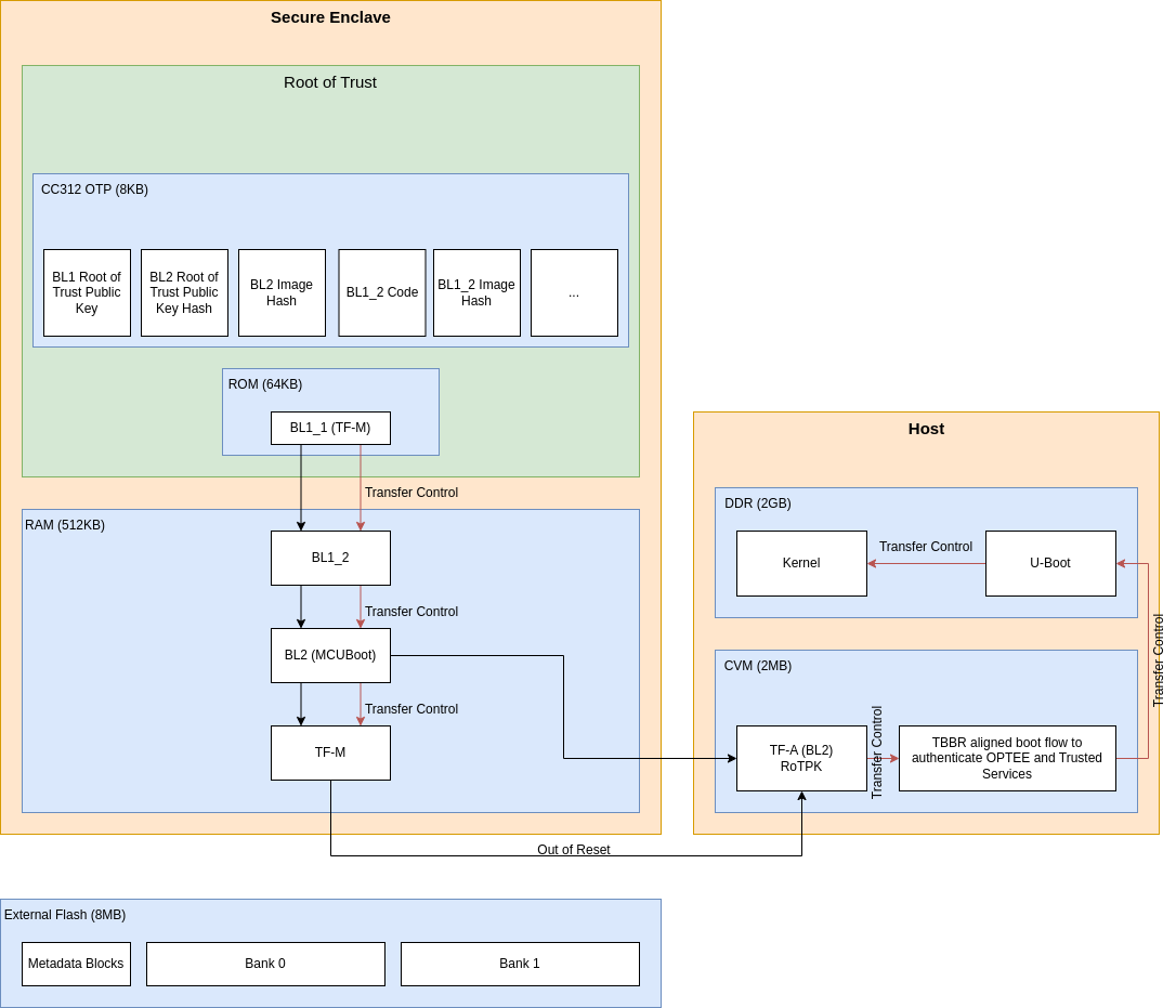

The Corstone-1000 boot uses a Secure boot chain process where an already authenticated image verifies and loads the following software in the chain.
For the boot chain process to work, the start of the chain should be trusted, forming the Root of Trust (RoT) of the device. The RoT of the device is immutable in nature and encoded into the device by the device manufacturer before it is deployed into the field. In Corstone-1000, the content of the ROM and CC312 One Time Programmable (OTP) memory forms the RoT.
Verification of an image can happen either by comparing the computed and stored hashes, or by checking the signature of the image if the image is signed.
SecureBootChain
It is a lengthy chain to boot the software on Corstone-1000.
TF-M BL1_1
On power-up, the Secure Enclave begins execution from TF-M BL1_1, which resides in ROM and serves as the Root of Trust (RoT) for the device.
TF-M BL1_1 is the immutable bootloader and is responsible for:
  • Provisioning the device during the first boot
  • Performing hardware initialization
  • Verifying the integrity and authenticity of the next stage in the boot chain
At boot time, TF-M BL1_1:
  • Copies the TF-M BL1_2 image from OTP to RAM.
  • Verifies the integrity of BL1_2 by comparing its computed hash with the hash stored in OTP.
TF-M BL1_2
During provisioning, the TF-M BL1_2 binary, along with its hashes and cryptographic keys, is stored in One-Time Programmable (OTP) memory.
Once verified, TF-M BL1_2:
  • Takes control and verifies the next stage in the boot chain, which is TF-M BL2.
  • Computes the hash of the BL2 image and compares it with the BL2 hash stored in OTP to ensure integrity before transferring execution to BL2.
Note
The TF-M BL1 design details can be found in the TF-M design documents.
Important
Corstone-1000 has some differences compared to this design due to memory (OTP/ROM) limitations:
  • BL1_1 code size is larger than needed because it handles most of the hardware initialization instead of the BL1_2.
  • BL1_2 cannot be updated during provisioning time because the provisioning bundle that contains its code is located in the ROM.
  • BL1_2 does not use the post-quantum LMS verification.
  • BL2 cannot be updated because it is verified by comparing the computed hash to the hash stored in the OTP.
TF-M BL2
In this system, TF-M BL2 refers to MCUBoot.
On the first boot, MCUBoot can provision additional cryptographic keys. It is responsible for authenticating both:
This authentication is done by verifying the digital signatures of the respective images.
MCUBoot performs image verification in the following steps:
  1. Load the image from non-volatile memory into RAM.
  2. Validate the image’s signature using the corresponding public key.
Note
The public key present in the image header is validated by comparing with the hash. Depending on the image, the hash of the public key is either stored in the OTP or part of the software which is being already verified in the previous stages.
The execution control is passed to TF-M after the verification. As the runtime executable of the Secure Enclave, TF-M initializes itself before bringing the Host system out of reset.

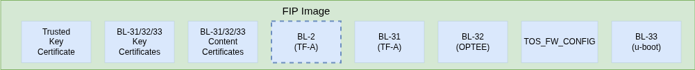

The Firmware Image Package (FIP) packs bootloader images and other payloads into a single archive.
FIPDiagram
The FIP for Corstone-1000 contains:
  • Trusted firmware-A BL2
  • AP EL3 Runtime firmware, BL31 image
  • AP Secure Payload, BL32 image
  • AP Normal world firmware -U-boot, BL33 image
  • Trusted OS Firmware configuration file used by Trusted OS (BL32), TOS_FW_CONFIG
  • Key certificates
  • Content certificates
To load and validate TF-A BL2, TF-M BL2 first parses the GUID Partition Table (GPT) to locate the FIP. It then determines the offset of TF-A BL2 within the FIP.

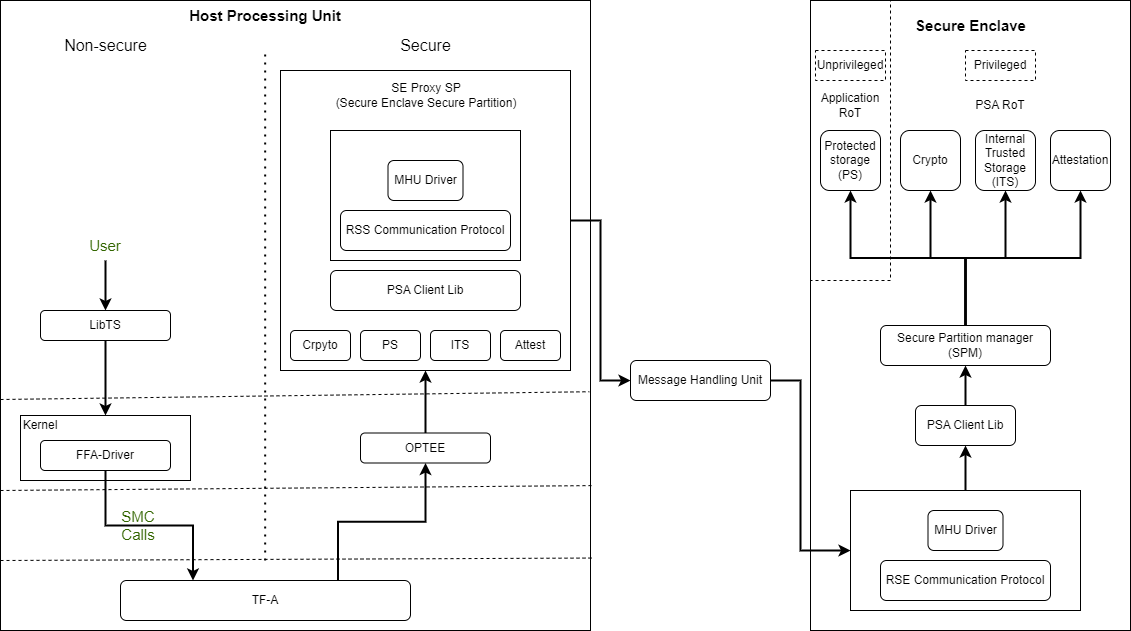

Secure Services
Corstone-1000 is unique in offering a secure environment for running trusted workloads. While the Host system includes TrustZone technology, the platform also features a hardware-isolated Secure Enclave, specifically designed to execute these secure workloads.
In Corstone-1000, essential Secure Services—such as Cryptography, Protected Storage, Internal Trusted Storage, and Attestation—are provided through PSA Functional APIs implemented in TF-M.
From the user’s perspective, there is no difference when communicating with these services, whether they run in the Secure Enclave or in the Secure world of the Host system. The diagram below illustrates the data flow for such calls.
SecureServices
The Secure Enclave Proxy Secure Partition (SE Proxy SP) is a proxy managed by OP-TEE that forwards Secure Service calls to the Secure Enclave. This communication uses the RSE communication protocol. While the protocol supports shared memory and MHU interrupts as a doorbell mechanism between cores, in Corstone-1000, the entire message is currently transmitted through the MHU channels. Corstone-1000 implements Isolation Level 2 using the Cortex-M0+ Memory Protection Unit (MPU).
Users can define their own secure services to run either in the Host system’s Secure World or in the Secure Enclave. This choice involves a trade-off between latency and security. Services running in the Secure Enclave benefit from strong, hardware-enforced isolation, offering higher security but at the cost of increased latency. In contrast, services running in the Host Secure World experience lower latency, but rely on TrustZone technology for virtualized isolation, which offers comparatively less robust security.

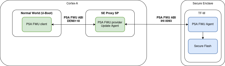

PSA Secure Firmware Update
The Arm Corstone-1000 platform necessitates a robust, secure, and flexible firmware update mechanism including partial capsule update to ensure fielded devices can receive critical patches, feature enhancements, and security fixes without compromising system integrity. To meet these requirements, we have implemented the Platform Security Architecture (PSA) Firmware Update (FWU) framework on Corstone-1000, leveraging Trusted Firmware-M (TF-M) for the Secure Enclave, U-Boot as the host-side client on Cortex-A, and the UEFI capsule update mechanism for payload encapsulation. This design supports both the Fixed Virtual Platform (FVP) and the Field Programmable Gate Array (FPGA) targets, providing consistent behavior across simulation and silicon-based deployments. The Corstone-1000 supports FWU which complies with the Platform Security Firmware Update for the A-profile Arm Architecture and PSA Firmware Update IHI 0093 specifications.
To standardize and streamline capsule creation with multiple FMP payloads, the EDK2 capsule generation tool tool has been integrated into the meta-arm Yocto layer for Corstone‑1000. This integration involves defining build rules for generating UEFI capsules as part of the firmware image build process. Configuration parameters exposed in the recipe allow developers to specify the number of FMP payloads, target image GUIDs, version numbers etc. This capsule ensures that all update payloads conform to the UEFI FMP specification and are ready for validation and delivery by U‑Boot.
The FWU solution for Corstone-1000 is composed of three primary domains:
  • Host System
  • Trusted Services intermediary
  • Secure Enclave
Each domain has distinct responsibilities and communicates through standardized interfaces.
SystemArchitecturePSAFirmwareUpdate
On the host side, U-Boot functions as the FWU client and orchestrates the update process from capsule retrieval to payload delivery based on PSA FWU DEN0018 specification via Arm FF-A framework. The Trusted-Services SE Proxy secure partition serves as a gateway between the non-secure host environment and the Secure Enclave. The PSA FWU service running in the Trusted Services implementation forwards the data to the Secure Enclave via MHU-based PSA calls. Within the Secure Enclave, the PSA FWU Agent, conforming to PSA Firmware Update IHI 0093 specification, orchestrates the actual flash programming, metadata management, and rollback protection mechanisms. The agent relies on a bespoke shim layer to abstract hardware‑specific flash operations and bootloader interactions.

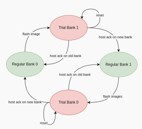

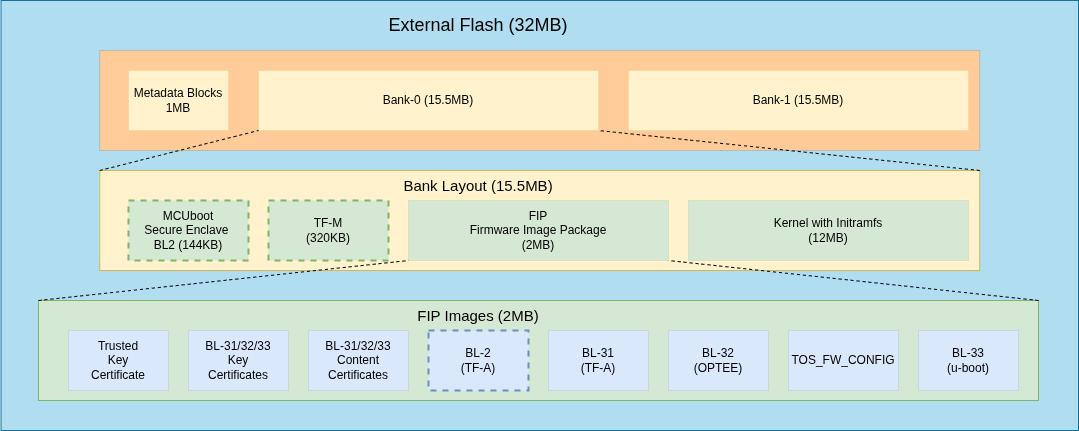

As defined in the specification, the external flash is divided into two banks: one bank holds the currently running images, while the other is used to stage new images.
There are four updatable components: BL2, TF-M, the FIP and the Kernel Image (the initramfs bundle). New images are delivered and accepted in the form of UEFI capsules.
ExternalFlash

  5. Trial Boot and Confirmation
    In trial mode, U-Boot evaluates the new firmware and issues either an accept or reject command using the PSA FWU ABI. These commands are sent to the Secure Enclave, instructing the shim to update the firmware metadata accordingly.
  6. Recovery and Fallback Mechanism
    If the trial boot is successful, the host sends an acknowledgment, transitioning the firmware state from ‘trial’ to ‘regular’.
    If the system fails or becomes unresponsive:
    A watchdog timer triggers a system reset. The BL1 firmware in the Secure Enclave detects repeated failures and reverts to the previously known-good flash bank. This rollback mechanism ensures the device remains operational and recoverable, even after a failed update.

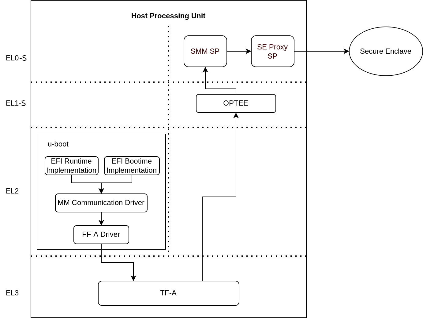

UEFI Runtime Support in U-Boot
The implementation of UEFI boot-time and runtime APIs requires persistent variable storage. In Corstone-1000, UEFI variables are stored using the Protected Storage (PS) service.
The diagram below illustrates the data flow for storing UEFI variables. U-Boot’s UEFI subsystem communicates with the Secure World using the U-Boot FF-A driver, which interfaces with the UEFI System Management Mode (SMM) service.
The SMM service provides support for the UEFI System Management Mode. This support is implemented by the SMM Gateway secure partition. The SMM service then uses the Proxy Protected Storage (PS) provided by the SE Proxy SP. These PS calls are forwarded to the Secure Enclave, following the communication path described earlier.
UEFISupport
