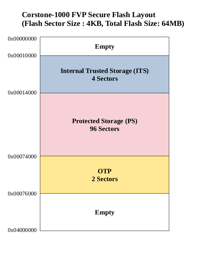

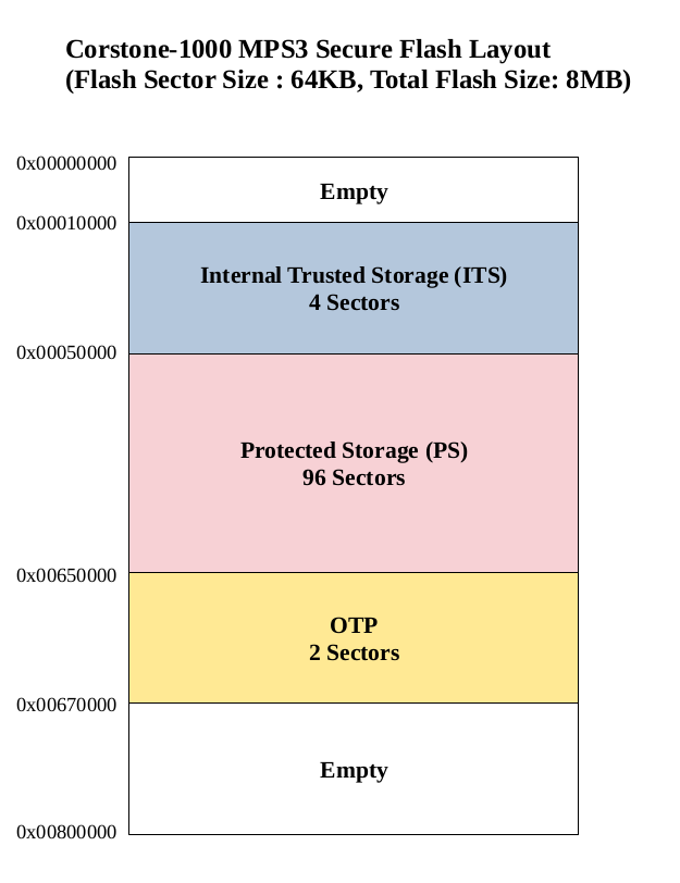

Corstone1000SecureFlashMPS3 Corstone1000SecureFlashFVP
Software running on the Secure Enclave is isolated via hardware for enhanced security. Communication with the Secure Enclave is achieved using Message Handling Units (MHUs) and shared memory.

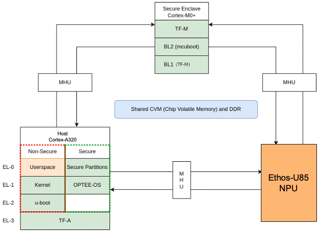

Corstone-1000 with Cortex-A320 Variant
This variant of the Corstone-1000 platform replaces the Host System’s Cortex-A35 processor with a Cortex-A320. In this configuration, the optional External System (previously a Cortex-M3) is replaced by an Arm Ethos-U85 Neural Processing Unit (NPU). The Ethos-U85 runs in the direct drive configuration, where the Host System is responsible for managing the NPU directly.

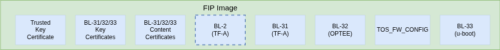

The Firmware Image Package (FIP) packs bootloader images and other payloads into a single archive.
FIPDiagram
The FIP for Corstone-1000 contains:
  • Trusted firmware-A BL2
  • AP EL3 Runtime firmware, BL31 image
  • AP Secure Payload, BL32 image
  • AP Normal world firmware -U-boot, BL33 image
  • Trusted OS Firmware configuration file used by Trusted OS (BL32), TOS_FW_CONFIG
  • Key certificates
  • Content certificates
To load and validate TF-A BL2, TF-M BL2 first parses the GUID Partition Table (GPT) to locate the FIP. It then determines the offset of TF-A BL2 within the FIP.

Bootloader Authentication
The FIP contains two types of certificates:
  • Content Certificates - used to store the hash of a bootloader image.
  • Key Certificates - used to verify public keys used to sign Content Certificates.
The Host system bootloader images are authenticated by computing their hash and comparing it to the corresponding hash found in the Content Certificate.
Certificates Verification
The public keys defined in the Trusted Key Certificate are used to verify the later certificates in the CoT process. The Trusted Key Certificate is verified with the Root of Trust Public Key.

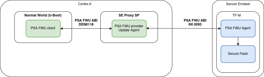

PSA Secure Firmware Update
The Arm Corstone-1000 platform necessitates a robust, secure, and flexible firmware update mechanism including partial capsule update to ensure fielded devices can receive critical patches, feature enhancements, and security fixes without compromising system integrity. To meet these requirements, we have implemented the Platform Security Architecture (PSA) Firmware Update (FWU) framework on Corstone-1000, leveraging Trusted Firmware-M (TF-M) for the Secure Enclave, U-Boot as the host-side client on Cortex-A, and the UEFI capsule update mechanism for payload encapsulation. This design supports both the Fixed Virtual Platform (FVP) and the Field Programmable Gate Array (FPGA) targets, providing consistent behavior across simulation and silicon-based deployments. The Corstone-1000 supports FWU which complies with the Platform Security Firmware Update for the A-profile Arm Architecture and PSA Firmware Update IHI 0093 specifications.
To standardize and streamline capsule creation with multiple FMP payloads, the EDK2 capsule generation tool tool has been integrated into the meta-arm Yocto layer for Corstone‑1000. This integration involves defining build rules for generating UEFI capsules as part of the firmware image build process. Configuration parameters exposed in the recipe allow developers to specify the number of FMP payloads, target image GUIDs, version numbers etc. This capsule ensures that all update payloads conform to the UEFI FMP specification and are ready for validation and delivery by U‑Boot.
The FWU solution for Corstone-1000 is composed of three primary domains:
  • Host System
  • Trusted Services intermediary
  • Secure Enclave
Each domain has distinct responsibilities and communicates through standardized interfaces.
SystemArchitecturePSAFirmwareUpdate
On the host side, U-Boot functions as the FWU client and orchestrates the update process from capsule retrieval to payload delivery based on PSA FWU DEN0018 specification via Arm FF-A framework. The Trusted-Services SE Proxy secure partition serves as a gateway between the non-secure host environment and the Secure Enclave. The PSA FWU service running in the Trusted Services implementation forwards the data to the Secure Enclave via MHU-based PSA calls. Within the Secure Enclave, the PSA FWU Agent, conforming to PSA Firmware Update IHI 0093 specification, orchestrates the actual flash programming, metadata management, and rollback protection mechanisms. The agent relies on a bespoke shim layer to abstract hardware‑specific flash operations and bootloader interactions.

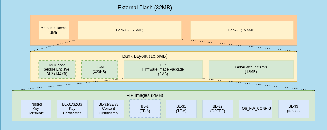

As defined in the specification, the external flash is divided into two banks: one bank holds the currently running images, while the other is used to stage new images.
There are four updatable components: BL2, TF-M, the FIP and the Kernel Image (the initramfs bundle). New images are delivered and accepted in the form of UEFI capsules.
ExternalFlash
When a FWU is initiated on Corstone-1000, the following sequence of operations takes place:
  1. Capsule Retrieval and Preparation
    U-Boot on the host system retrieves the firmware capsule. It validates the capsule header and parses the FMP (Firmware Management Protocol) descriptor list to identify the payloads to be updated.
    For each FMP descriptor, U-Boot:
    Splits the firmware payload into 4 KiB chunks. Invokes the PSA_FWU_Update API for each chunk, transmitting the buffer address via the FF-A (Firmware Framework for Arm) shared memory interface.
  2. Secure Transmission and Forwarding
    The PSA Firmware Update (FWU) service, running as part of Trusted Services, receives the chunks through Secure Partition Client (SPC) calls. It forwards these chunks to the Secure Enclave using MHU-based PSA calls.
  3. Flashing Within the Secure Enclave
    Inside the Secure Enclave, the PSA FWU Agent dispatches each chunk to the shim layer.
    The shim layer:
    Erases the corresponding sectors in the non-active flash bank. Writes the received firmware chunks at the correct offsets. During partial updates, it also copies static partitions from the active bank to the non-active one to maintain consistency.
  4. Finalization and Boot Preparation
    After all chunks are successfully written:
    The shim updates the firmware manifest and the EFI System Resource Table (ESRT) entries to reflect the new image version. This step enables the bootloader to recognize the new firmware for a trial boot. The platform then performs an automatic reset, booting into the non-active bank in trial mode.

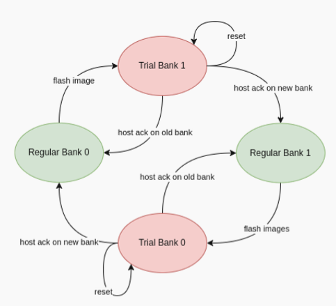

  5. Trial Boot and Confirmation
    In trial mode, U-Boot evaluates the new firmware and issues either an accept or reject command using the PSA FWU ABI. These commands are sent to the Secure Enclave, instructing the shim to update the firmware metadata accordingly.
  6. Recovery and Fallback Mechanism
    If the trial boot is successful, the host sends an acknowledgment, transitioning the firmware state from ‘trial’ to ‘regular’.
    If the system fails or becomes unresponsive:
    A watchdog timer triggers a system reset. The BL1 firmware in the Secure Enclave detects repeated failures and reverts to the previously known-good flash bank. This rollback mechanism ensures the device remains operational and recoverable, even after a failed update.

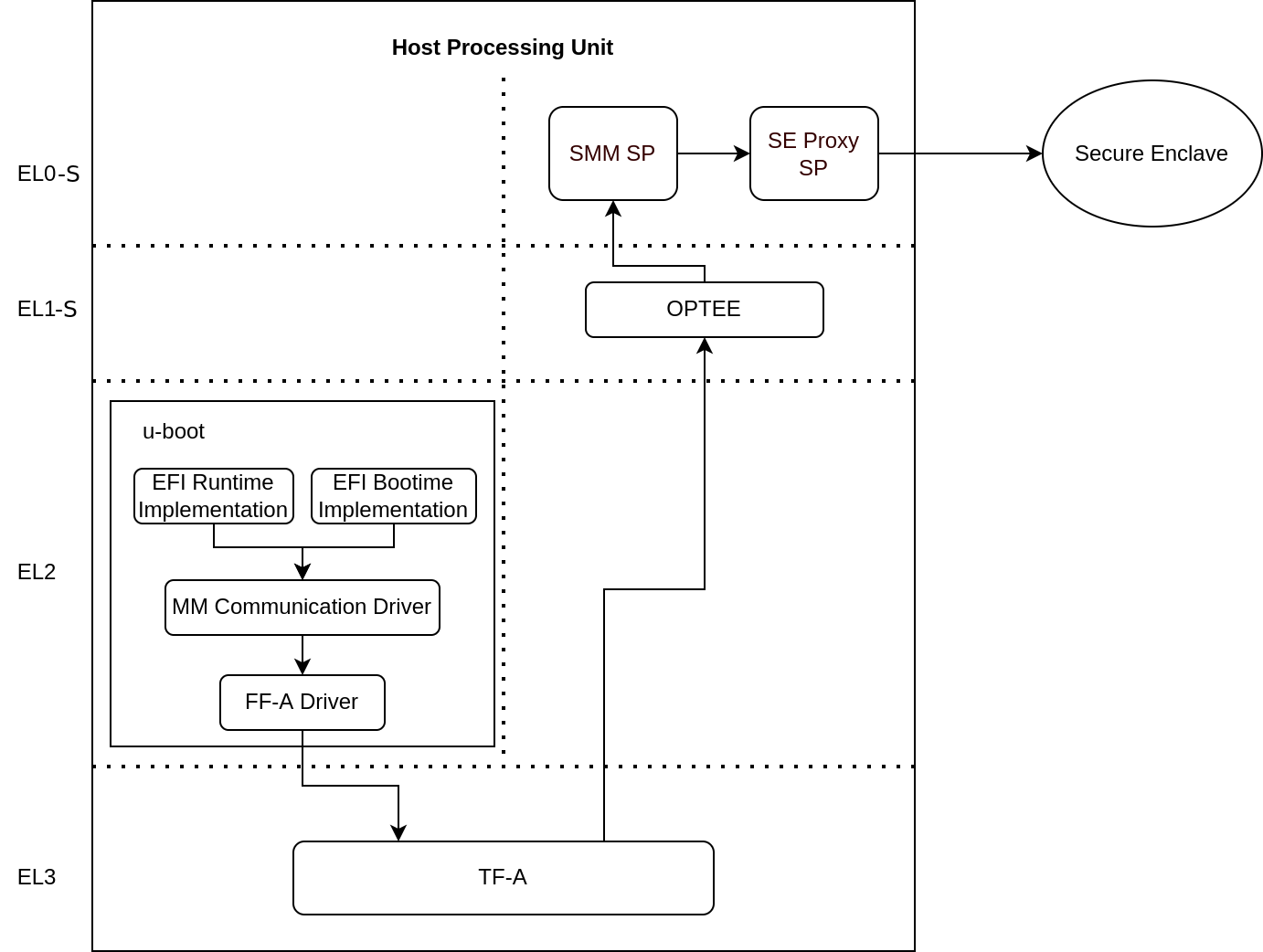

The diagram below illustrates the data flow for storing UEFI variables. U-Boot’s UEFI subsystem communicates with the Secure World using the U-Boot FF-A driver, which interfaces with the UEFI System Management Mode (SMM) service.
The SMM service provides support for the UEFI System Management Mode. This support is implemented by the SMM Gateway secure partition. The SMM service then uses the Proxy Protected Storage (PS) provided by the SE Proxy SP. These PS calls are forwarded to the Secure Enclave, following the communication path described earlier.
